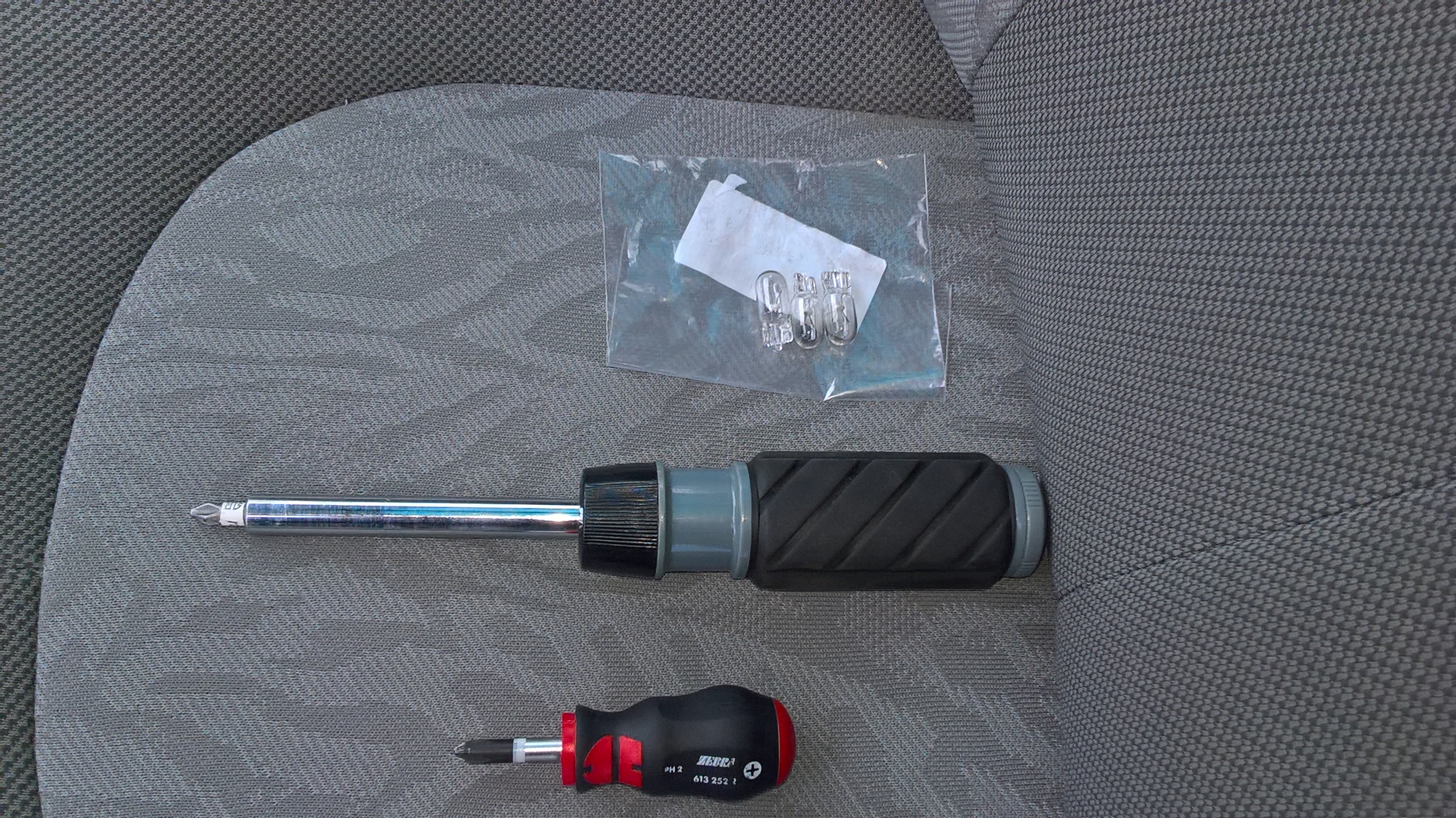

NÁŘADÍ: KŘÍŽOVÝ ŠROUBOVÁK DLOUHÝ, KŘÍŽOVÝ ŠROUBOVÁK KRÁTKÝ
UPOZORNĚNÍ:PRO JISTOTU MINIMÁLNĚ VYPLÉ ZAPALOVÁNÍ – JEŠTĚ LÉPE ODPOJENÁ AUTOBATERIE
DÍLY:
- CELOSKLĚNĚNÁ ŽÁROVKA S PATICÍ W2.1X9.5d T10 - 12V – 3,4W
- LZE POUŽÍT LÉPE DOSTUPNÉ ŽÁROVKY W3W 12V 3W ČI W5W 12V 5W
- ORIGINÁL DÍL AMR6207

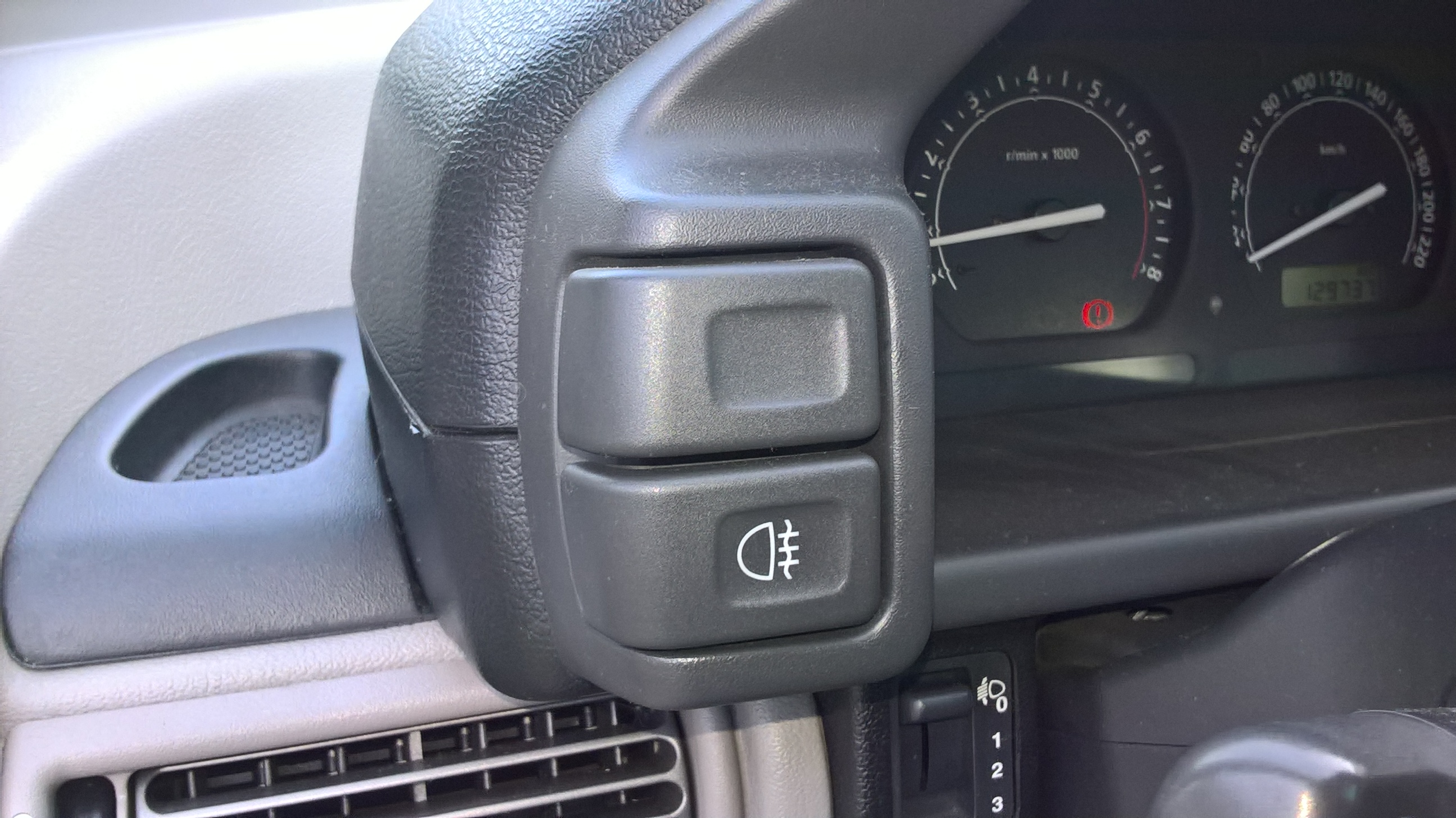

1. ZAPIŠTE ČI VYFOŤTE SI PŘESNOU POLOHU SPÍNAČŮ
VOLANT DEJTE DO NEJNIŽŠÍ MOŽNÉ POLOHY.

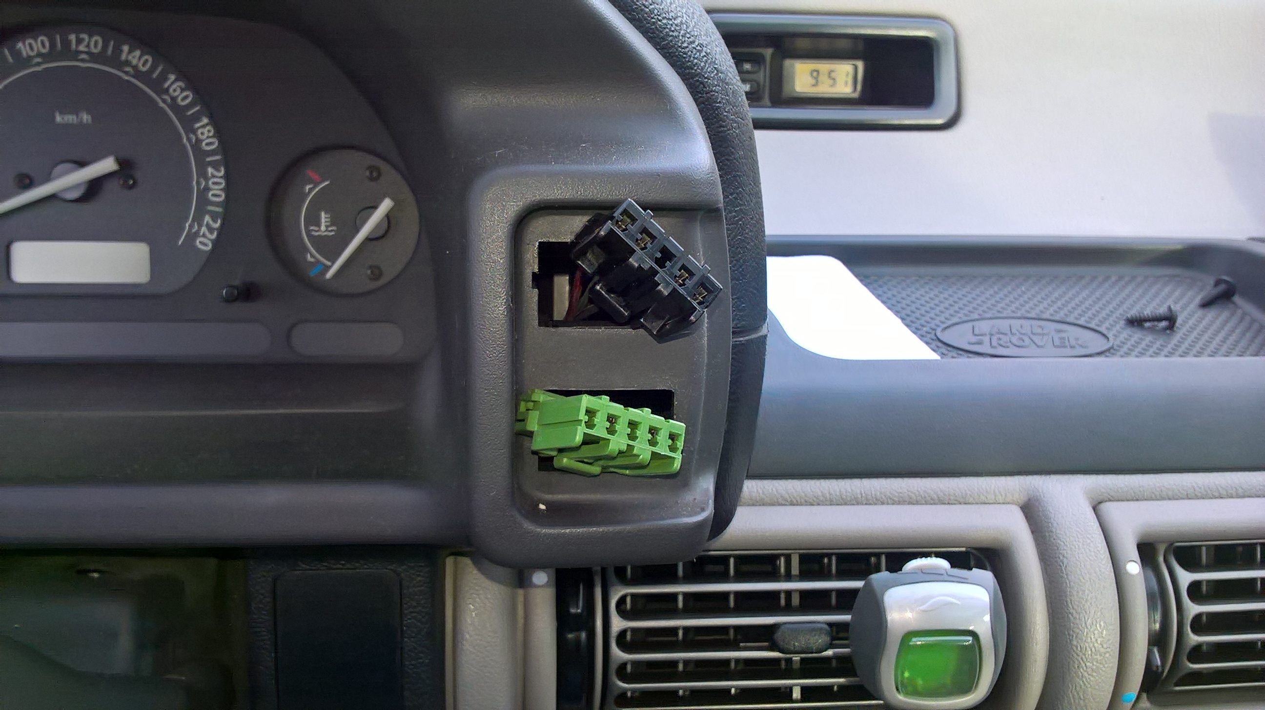

2. DEMONTUJTE VŠECHNY SPÍNAČE VČ. PŘÍPADNÉHO PRÁZDNÉHO.
DEMONTÁŽ TAK, ŽE POVYTÁHNETE CELÝ SPÍNAČ OPATNĚ VEN.

3. ODPOJTE SPÍNAČE OD ELEKTRIKY ODPOJENÍM KONEKTORU.
ZAPIŠTE ČI VYFOŤTE SI PŘESNOU POLOHU KONEKTORŮ

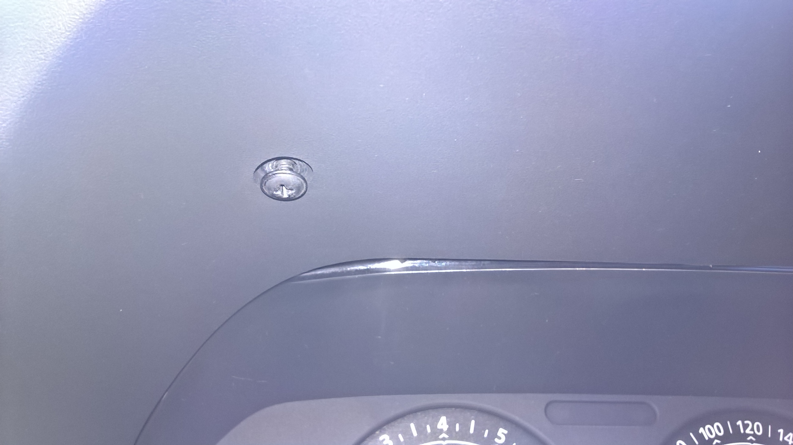

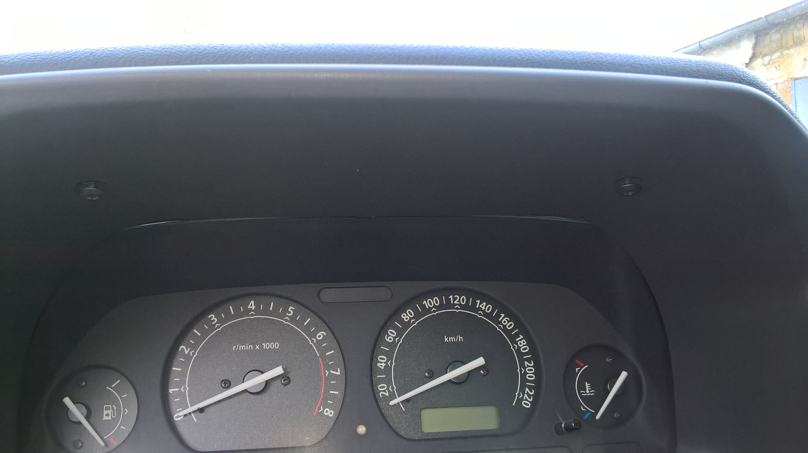

4. DEMONTUJTE 2X KŘÍŽOVÝ ŠROUB, KTERÝ SE NACHÁZÍ V HORNÍ ČÁSTI PLASTOVÉHO ŠTÍTU ZE SPODNÍ STRANY – JAKO PŘED BUDÍKY

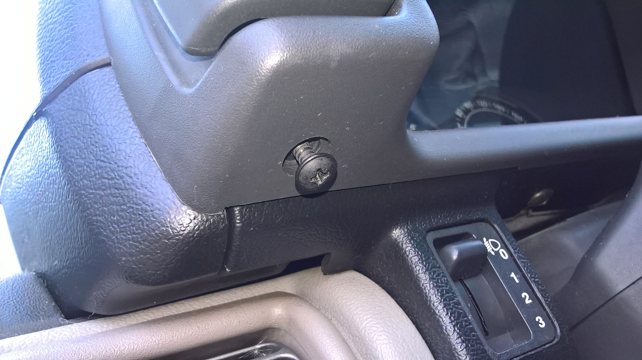

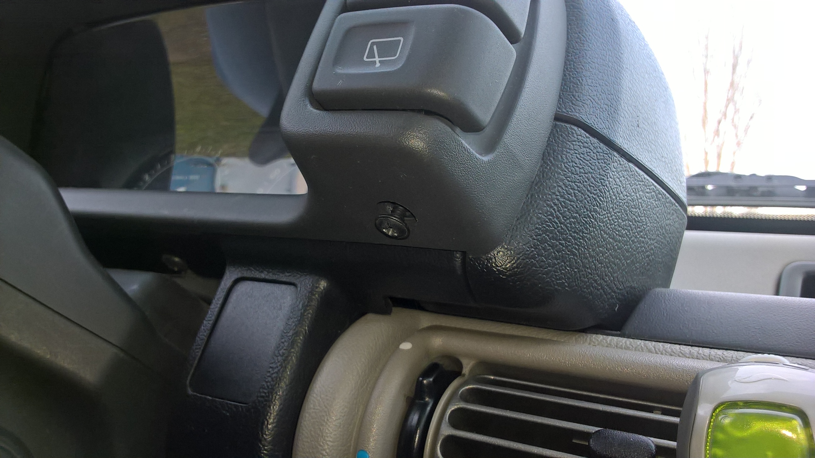

5. DEMONTUJTE 2XKŘÍŽOVÝ ŠROUB, KTERÝ SE NACHÁZÍ NA LEVÉ A PRAVÉ STRANNĚ PLASTOVÉHO KRYTU – UMÍSTĚNÍ ZE SPODNÍ ČÁSTI PLASTOVÉHO KRYTU

6. VYJMĚTE PLASTOVÝ KRYT KOLEM BUDÍKŮ SMĚREM K VOLANTU

7. DEMONTUJTE 2XKŘÍŽOVÝ ŠROUB NA LEVÉ A PRAVÉ STRANĚ BUDÍKŮ.
TÍM UVOLNÍTE HORNÍ PLASTOVÝ KRYT NAD BUDÍKY, KTERÝ VYTÁHNETE SMĚREM NAHORU.

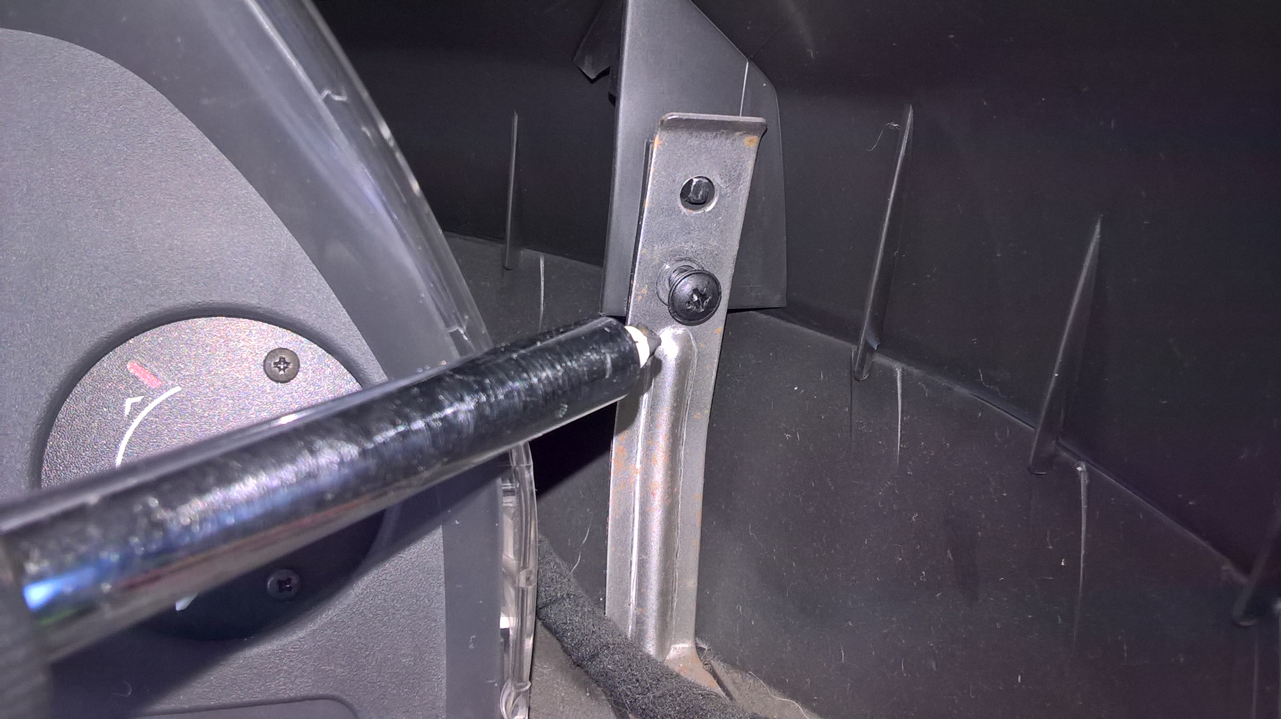

8. PO ODSTRANNÍ HORNÍHO PLASTOVÉHO KRYTU VZNIKNE PŘÍSTUP K 2X KŘÍŽOVÝM ŠROUBKŮM, KTERÉ DRŽÍ JIŽ SAMOTNÝ DÍL S BUDÍKY. OBA DEMONTOVAT.

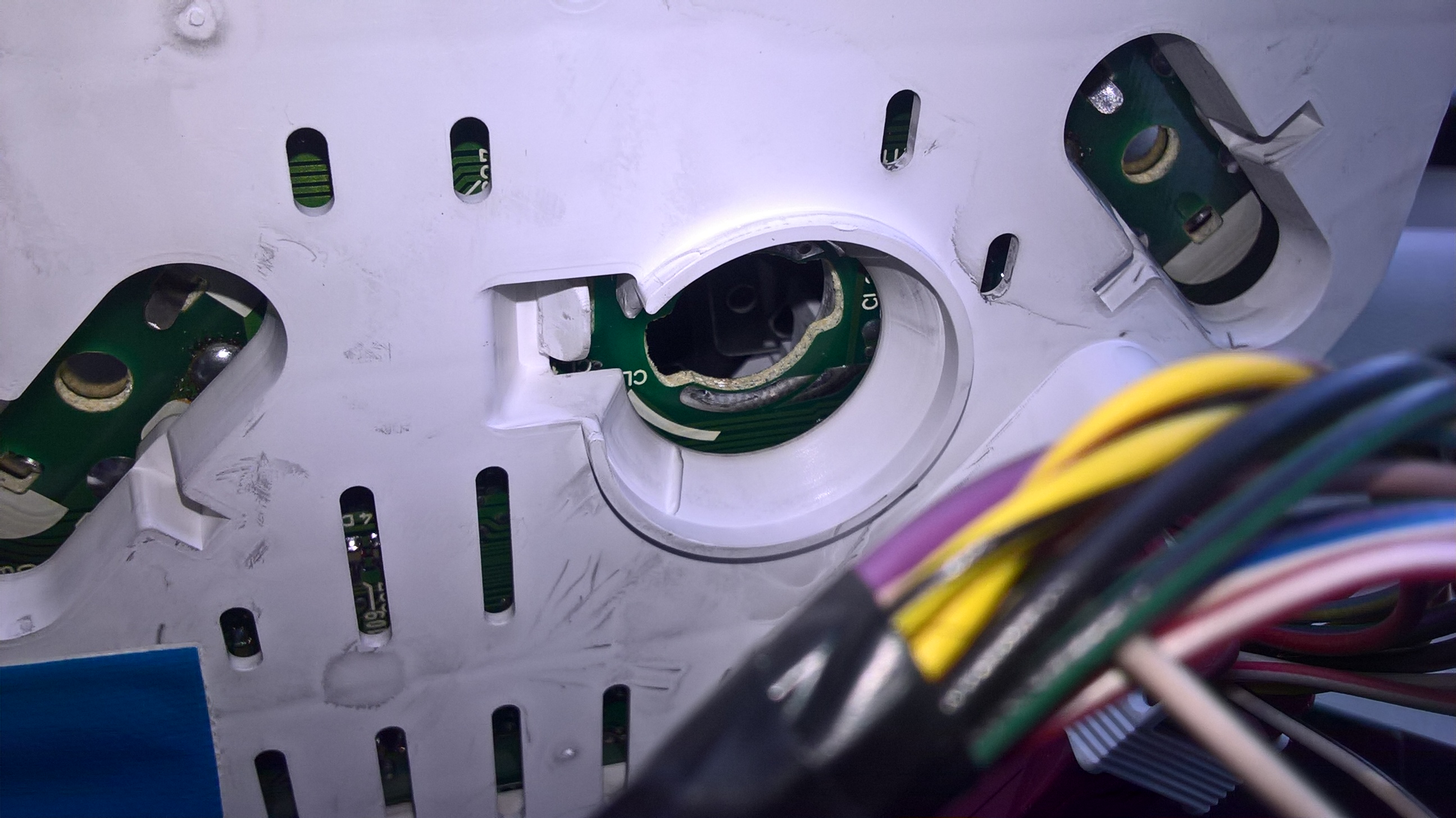

9. DEMONTUJTE 2X KŘÍŽOVÝ ŠROUB NA LEVÉ A PRAVÉ STRANĚ , JSOU UMÍSTĚNY POD BUDÍKY A KTERÉ DRŽÍ JIŽ SAMOTNÝ DÍL S BUDÍKY. PO ODMONTOVÁNÍ JE MOŽNÉ DÍL S BUDÍKY VYJMOUT. ELEKTRIKA BUDÍKŮ SE NEMUSÍ ODPOJOVAT A JDOU OPATRNĚ CELÉ OTOČIT, ABY VZNIKL PŘÍSTUP K ŽÁROVKÁM OSVĚTLENÍ BUDÍKŮ.

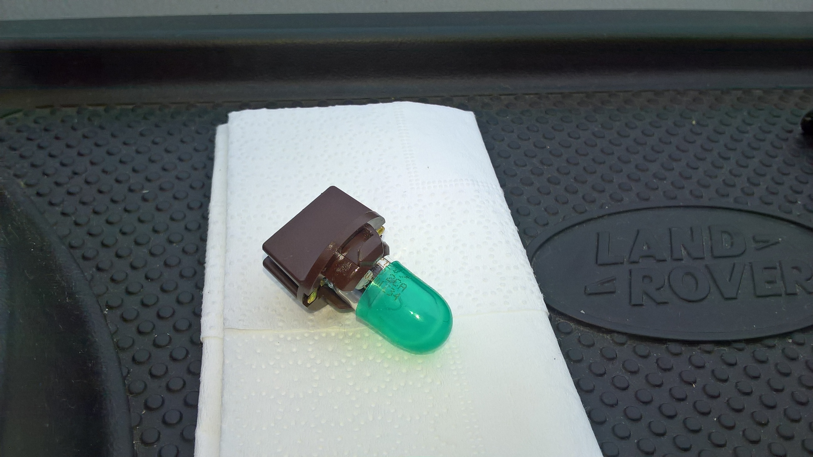

10. PATICE SE ŽÁROVKOU SE VYJME MÍRNÝM OTOČENÍM. PO VYJMUTÍ HNĚDÉ PATICE JDE ŽÁROVKA Z PATICE VYNDAT. V MÉM PŘÍPADĚ JE ŽÁROVKA OPATŘENA ZELENOU SILIKONOVOU KRYTKOU, KTERÁ JDE OPATRNĚ SUNDAT A PŘENDAT NA NOVOU ŽÁROVKU.
SAMOZŘEJMĚ NEJLÉPE JE POUŽÍT ORIGINÁLNÍ DÍL AMR6207.
ŽÁROVKA MÁ 3.4W 12V ( PATICE W2.1X9.5d či také T10 )
LZE POUŽÍT LÉPE DOSTUPNÉ W3W ( MENŠÍ SVÍTIVOST ) ČI W5W ( VĚTŠÍ SVÍTIVOST )
W5W BUDE I PRODUKOVAT VÍCE TEPLA, ALE NEMĚLO BY TO BÝT TAK VÝRAZNĚ HODNĚ.
VÝBĚR ZÁLEŽÍ POUZE NA VÁS.
