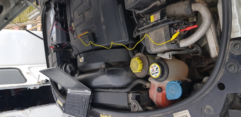

Do webasta jsem se úspěšně dostal, smazal chyby a ručně nastartoval webasto, po nějaké době i motor.
![2018-11-30 12.47.51.jpg (1.19 MiB) Zobrazeno 4214 x Já volil https://www.ebay.com/itm/WEBASTO-v3-0-USB-INTERFACE-DIAGNOSTIC-CABLE-HEATER-Thermo-Test-E-P-Z-C-V-EVO/222870477293?ssPageName=STRK%3AMEBIDX%3AIT&_trksid=p2060353.m2749.l2649](./download/file.php?id=95913&t=1&sid=c67eb2bb34eb324d892c95bd05662eba)
- Já volil https://www.ebay.com/itm/WEBASTO-v3-0-USB-INTERFACE-DIAGNOSTIC-CABLE-HEATER-Thermo-Test-E-P-Z-C-V-EVO/222870477293?ssPageName=STRK%3AMEBIDX%3AIT&_trksid=p2060353.m2749.l2649

Teď večer jsem udělal diagnostiku:
Diagnosis report Webasto Thermosystems
Configuration:
W-Bus version...............................................................3.3
Device name...............................................................L5 SH
W-Bus code.......................................................717CC0E73F8000
Fuel type................................................................Diesel
Circulating pump in control idle period.......................................0
Heating duration limitation.................................................255 [min]
Factor for shortening of ventilation duration...............................1/1
Device identification number..........................................09005946F
Dataset identification number.......................................09006807J05
Software identification number........................................000000000
HW version................................................................45/04
SW version...................................................Friday/45/04 11.14
SW version (EEPROM)..........................................Friday/45/04 11.14
Date of manufacture control unit.......................................06.09.05
Date of manufacture heater.............................................22.09.05
Customer identification number........................................JEC500790
Serial number........................................................0000977083
Test signature.............................................................4343
Minimum voltage threshold....................................................10 [V]
Maximum voltage threshold....................................................16 [V]
Delay for supply voltage min. detection......................................20 [s]
Delay for supply voltage max. detection.......................................6 [s]
Operating data:
Working hours............................................................301:34 [h:m]
Operating hours.........................................................7351:56 [h:m]
Start count...............................................................24643
Burning duration PH 1..33%.................................................0:00 [h:m]
Burning duration PH 34..66%................................................0:00 [h:m]
Burning duration PH 67..100%...............................................0:00 [h:m]
Burning duration PH >100%..................................................0:00 [h:m]
Burning duration SH 1..33%.................................................0:00 [h:m]
Burning duration SH 34..66%................................................0:00 [h:m]
Burning duration SH 67..100%...............................................0:00 [h:m]
Burning duration SH >100%..................................................0:00 [h:m]
Working duration PH........................................................2:02 [h:m]
Working duration SH.....................................................1038:45 [h:m]
Start counter PH.............................................................22
Start counter SH...........................................................3772
Ventilation duration.......................................................0:00 [h:m]
Error:
Fault 1...............................................Car is almost out of fuel
State of fault.............................................stored, not actual
Code......................................................................24h
Counter.....................................................................1
Temperature................................................................72 [°C]
Operating state................................Combustion process full load 1
Voltage.................................................................14,47 [V]
Operating hour counter................................................7349:16 [h:m]
Fault 2................................................................No start
Code......................................................................02h
Counter.....................................................................4
Temperature................................................................73 [°C]
Operating state....................................................Glowing 71
Voltage.................................................................14,49 [V]
Operating hour counter................................................7351:25 [h:m]
30.11.18 16:29:32 Webasto Thermo Test 2.16.1
Smazal jsem chyby a nyní je stav následující, webasto začne po startu zapalovat, kouřit pak se tam asi pustí nějaký ventilátor a ten plamen sfoukne. Kouř zmizí, začne dochlazování a končí to následující hláškou.
1. Chyba se nedostatkem paliva se již nezobrazuje
2. Chyba
Je stále.
Nevím kde začít, jek jsem řekl, auto mám první zimu a nevím jak webasto jezdilo ani fungovalo.
Napadá někoho něco? Díky!
